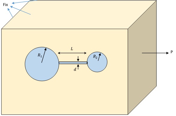

I am trying to model the deformation of two cavities inside a domain that are connected with a channel to each other same as bellow:
The material of the domain is soft, and the cavities and the channel are filled with water. After applying the forces (let say uni-axial load in the direction of channel), since the channel's diameter is very small, the channel will collapse and contact will happen there. I use the following configurations:
But Whatever I am doing the contact cannot stay stable and cannot converge like:
This is an static run. I solve the fluid part with fluent (steady) and I use system coupling. I tried different configurations like adding relaxation parameter (0.1 and 0.3), or playing with Pinball radius but nothing help this problem. I also increased the number of substeps to 10 but it changed nothing. Because of using system coupling I cannot use Auto timing steps and I have to define the problem with substeps. Also I need to have offset in my contact because this simulation is paired with fluent. This question is also very similar to other problem that I posted earlier:

Let me explain my model in more detail:
I have a soft cubic material (using Ogden or Neo-Hookean for modeling the hyperelastic material). Inside the cube, there are two spherical cavities with radius (R_1) and (R_2). These two spherical cavities are connected with a cylindrical channel that has a radius of d and length of L. Inside the cylindrical channel and two cavities are filled with water. When I apply forces to one side of the soft cubic material, the cavities and channel will deform. But there is water inside the channel that is in-compressible and will not let the channel to deform in any shape that it wants. I use Fluent to solve for the hydro-static pressure inside the cavities (I heard that there is also a hydro-static elements in structure that I can replace but I do not know about it so I am using Fluent).
So by different model, I meant that, I play with my variables. For example initial R_1/R_2=1 but if I increase R_2, the solution will not work. Or I can increase the length of the channel and when it is very big (L=10 R_1) it will not work.
