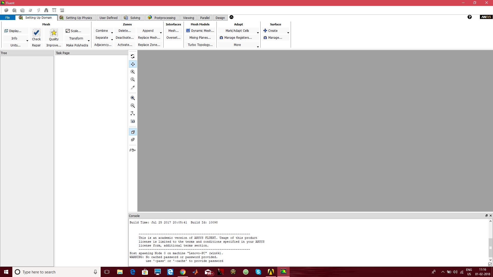

ashwintwister
SubscriberHi there. This is ashwin. I am recently encountering a problem with my fluent 18.2. Geometry and meshing are working perfectly. The real problem comes with using setup (fluent 18.2). I receive an error saying that "no cached password. please type '-cache' or '-pass' to enter you password". Can someone help me with this? Because of this my project has got stagnated. please help me with this. You can also mail me via ashwintwister@gmail.com . That will be of great help ppl. I am currently using latest version of Windows 10 and Lenovo laptop.

Vishal Ganore
Ansys EmployeeI think you need full windows update or install .NET frame work from here.
https://www.microsoft.com/en-us/download/details.aspx?id=17113
After .net installation, restart your PC and try installing 18.2.
