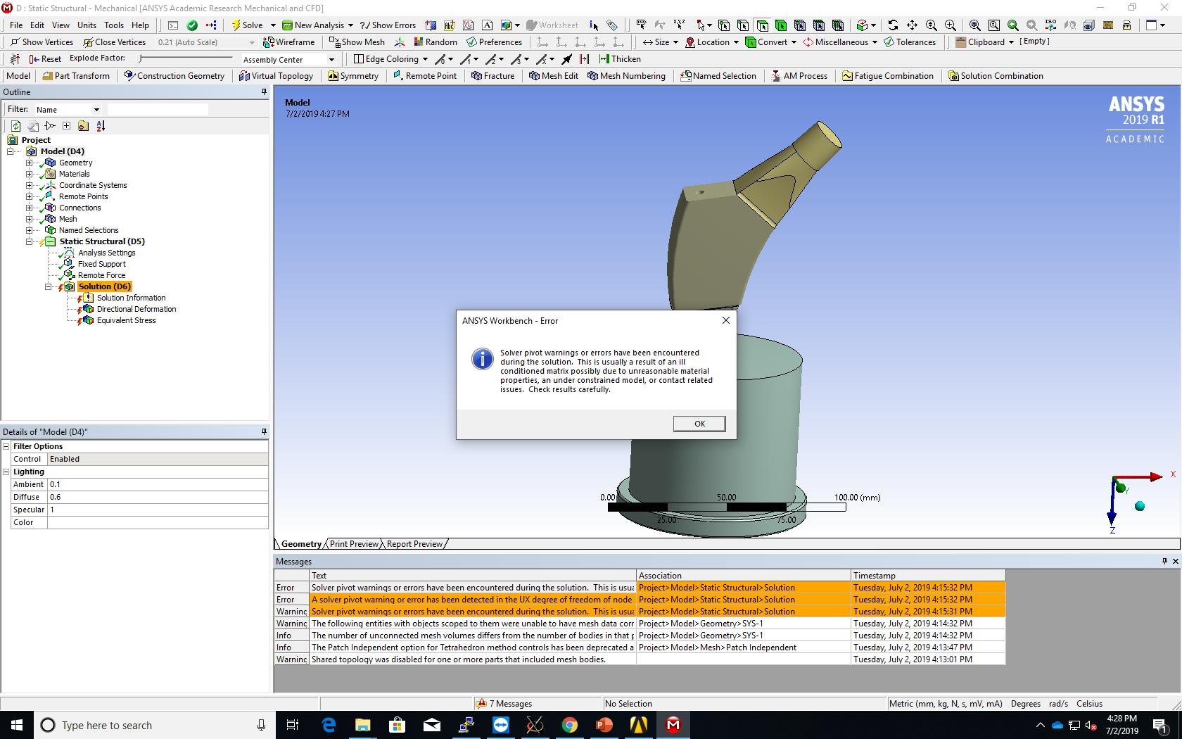

SubscriberHi everyone, I am trying to do an analysis and I am getting several errors related to solver pilot error and mesh.
This analysis is a validation run after doing lattice topology optimization. So I think a lot of the issues are resulting from the nature of the new geometry. The pictures which follow this message have some of the error messages. The file is too large to upload so it can be accessed via this google drive link https://drive.google.com/file/d/1h9yxYkKnx0-XKoRuNeXwf5Mc_N1G84f-/view?usp=drive_web.
Any advice and instructions how to solve this will be appreciated
Thanks.

Goddy
SubscriberSorry about that. Try again now hopefully you have access
https://drive.google.com/open?id=1h9yxYkKnx0-XKoRuNeXwf5Mc_N1G84f-
July 3, 2019 at 9:29 am
jj77
SubscriberIt is the lattice part - the lattice mesh is not really done never used lattices so not sure - things inside there are not really connected as it is.
(try an element size that is close to the diameter of the lattice say 0.25 mm)
