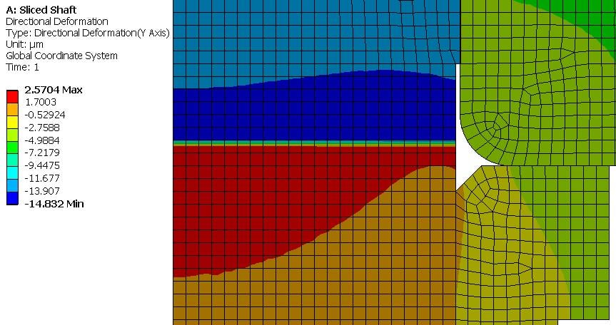

Thank you for your reply I applied the bolt pretension as you suggested. But I ended up in another problem. This assembly is bit different to the assembly shown above.
In this assembly there's stress singularity near a fillet (please check results at 1st load step, which is included in the simulation file). I have attached the file below. But I didn't include all the mesh convergence steps due to increase of file size.
How to come up with a proper results for this kind of situation?
Also why this kind of stress occurs when there is no sharp corner in the component.

SubscriberHi Rashiga,
Shaft has been sliced into 3 pieces so that the nut can be bonded to one part, the bolt pretension can be applied to another part, and the frictional contact can be applied to top part. In this way, the location where the Bolt Pretension occurs is well controlled.
You thought you had a stress singularity because the stress went up when the element size went down from 0.025 to 0.0125. If you have a true singularity, the stress might double when the element size is cut in half. Your example did go up by a significant amount, but it was not close to doubling. You just needed to go smaller and smaller to see that the stress does indeed converge on an exact value. I created a Parameter Set with Edge Size as the input variable and Maximum von Mises Stress as the output variable. Here is the result.
There is no stress singularity between the nut and the disk. There is the expected subsurface Hertz contact stress. Look at Figure 3.8 in this reference.
However, with a 0.0125 mm element size, it looks like this:
A more efficient mesh uses a Sphere of Influence mesh control that only puts small elements where they are needed,
at the Hertz contact stress location. That archive is also attached.

1. When you add the bolt pretension on the split body the force actually applies on the middle of the body right? But to properly simulate the effect of the bolt pretension shouldn't the pretension force be applied on the middle of the body which is clamped by the bolt and the nut? (in the middle of the disk as for this example)
2. Is there a particular reason for applying the bolt pretension to the body similar to what you have done here?
3. I have tried to do simulation with design points but I failed because when the number of elements changed in each iteration. It will remove the remote point which I have attached to a mesh node, since when the number of elements change in the edge ANSYS redo all the mesh to continue the simulation. How did you stop that from happening? Hope you understand my question.
Thanks.
Best Regards,
Rashiga
May 19, 2018 at 2:41 pm
SubscriberDear Rashiga,
3) In my archive, the remote point is scoped to a vertex and not a node, so it is persistent after remeshing.
1) The way bolt pretension works is that it splits the body in half and grabs the two new faces created and pulls them together with the force that was specified. In the image below, you can see the Y-deformation of the Bolt Pretension, which creates the appropriate tension forces in the top and bottom parts of the shaft.
2) Controlling where the program splits the body to apply the Bolt Pretension is the reason to split the shaft into 3 pieces.
