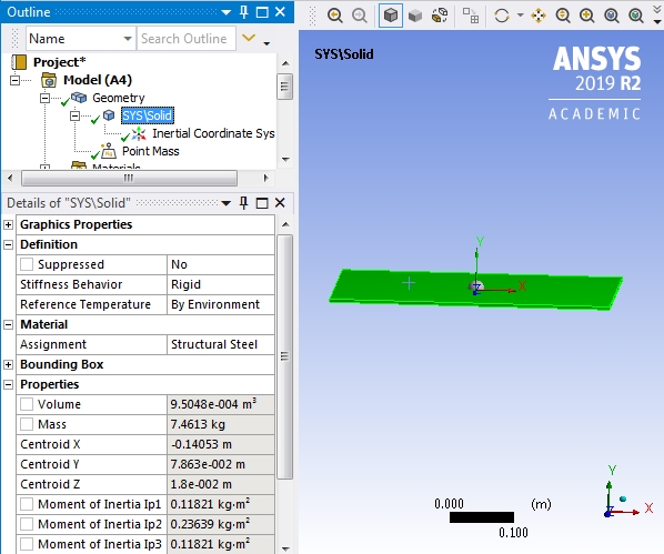

SubscriberI want to simulate the angular rotation of a tracker about z-axis, hinged at (0,0), due to fluid forces. I have a plate fixed over a torsional shaft as shown. The flat plate has a mass moment of inertia about the rotation axis of J= 260 kgm2, The shaft has a spring stiffness of 6 KNm/rad. I know the values of J,K,damping ratio. Not interested in stress, strains, etc.I am interested in only rigid body rotation. I want to plot the angular displacement wrt time due to fluid forces.

SubscriberI drew a plate, but as you can see, the value of J is way too small. It would be easy if you have the dimensions of the plate.
I can add a Point Mass and assign the value of J, but that is about the point, not the Z axis.
It would be better to know the coordinates of the plate relative to (0,0) and calculate J around the origin.
A Revolute Joint is defined between the plate and ground. Here the value of k and damping can be defined.
The center of rotation of this joint is (0,0).
Apply a force for 10 ms, then let it ring for 5 seconds.

I have set the material properties of the plate such that Ip3 shows 259 kgm2 (I believe it is the mass moment of inertia about z-axis!). Doing so, I am not using any point mass. Now by customizing mat properties, I also get large values Ip1 and Ip2. I believe these are mass moment of inertia about x and y axes respectively. In such a case, the plate rotates about x and y also and displaces.
Can you specify which constraint or fixity conditions to be used to get only rotation about z-axis and no displacements in x,y,z or rotation in x,y?
July 30, 2019 at 11:43 am
SubscriberAdd a Revolute Joint to ground. You can edit the Z axis to point in the direction you want and put the origin where you want it.
