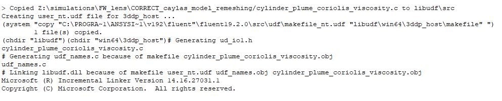

I am trying to load a previously run model on a new workstation. I copied the case and data file, libudf folder, and the udf file itself to my new working folder. I loaded the case and date files and get the following error:
The UDF library you are trying to load (libudf) is not compiled for parallel use on the current platform (win64). The system cannot find the file specified. (file name is libudf.dll)
When I do this on other workstations I have no problem. The compiler loaded on these is visual studio. I also attempted to unload and reload the udf and re-build the folder, which did not work. It gave the same error.
In the directory, the libudf folder is created, but the file which Fluent cannot find is not created when the library is built.
What could be causing this?

SubscriberWhen compiling in a new case file, I get the following output when loading "(chdir "libudf")(chdir "win643ddp_host")'nmake' is not recognized as an internal or external command, operable program or batch file"
June 27, 2019 at 3:15 pm
Rob
Ansys EmployeeThe computer you're on doesn't have a compiler, or it's not linked correctly.

I was able to find the command prompt you mentioned and after inputting cl t I received the following error:
/out:t.exe
t
LINK : fatal error LNK1104: cannot open file 't.exe' -
June 28, 2019 at 1:50 pm
DrAmine
Ansys EmployeeIf "cl" result in that then you need to cleanup everything and re-install as Admin with the instructions from the Solution suggested.
