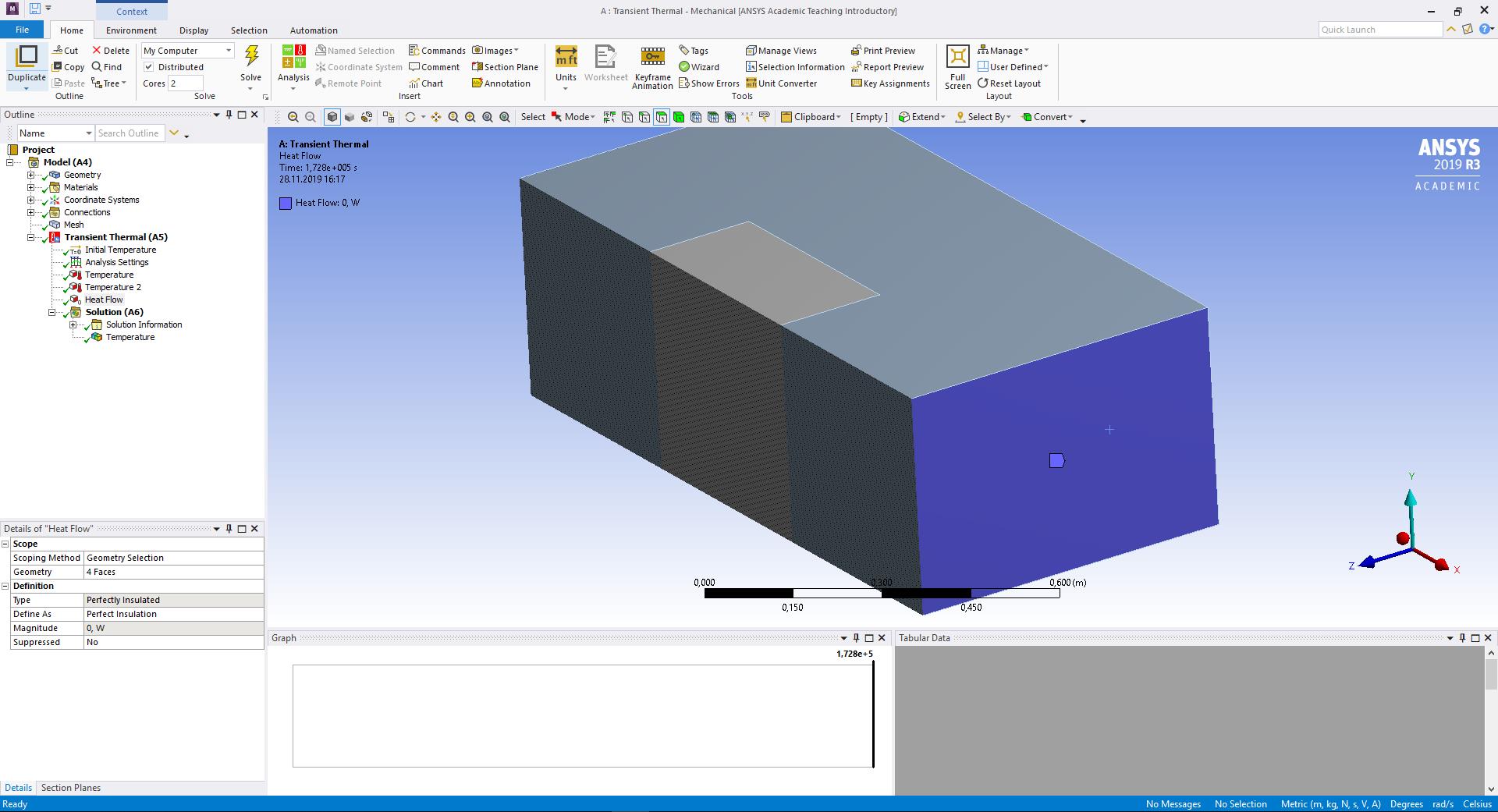

my goal is to look how a block of wood reacts, when it cools down. My setting is quite simple. I have a cubic block of wood which is isolated all around with EPS. At the top the block gets cooled down from 20 to -160 C°. As solution I just want the temperature distribution. The complete bottom of the modell has a steady temperature of 20°C. Also the upper layer of the EPS.
So the highest temperature in the System is 20°C and the lowest -160° but the max. and min. temperature shown in the solution is +72°C and -340°C. Do anyone know, how that can happen and how I maybe should change the model to get the solution fixed? Actually the grafic output looks logical and right but there are still this way to high and low temperatures.

SubscriberThe website is broken today and no one can attach images.
If you make the element size half of the current size, do the results improve? If you are not on a Student license with node/element limits, you can cut the element size in half again. Plot out how the maximum and minimum values change as a function of element size.

I did a parametric study and it didnt solve the problem completely. The maximum temperature gets near the implemented one, but the minimum temperature stays at -200C°.
So now I also can send the pictures of the setup.
At first the perfectly isolated outside.
The Temperatue at the top of the wooden block sinking over time until -160C°.
The isolation which stays at 20C° because of the overall environmental temperature.
And at last the visualization of my first test.
