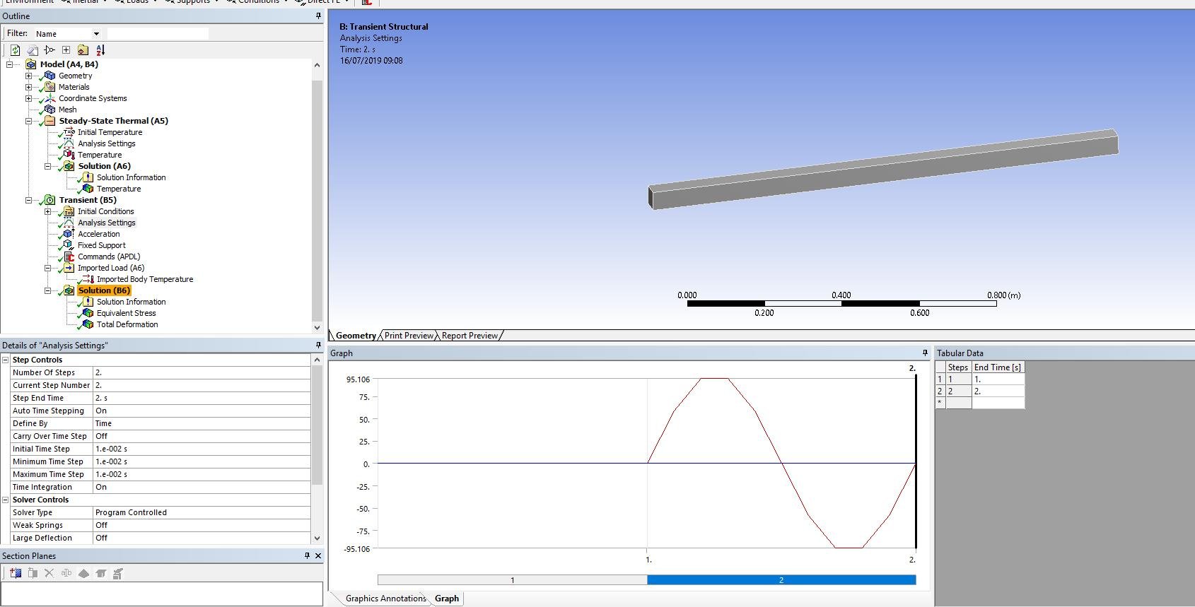

SubscriberI think the best thing is to do all of that in one single transient since you have a harmonic load you can define there a sinus.
(Now you just consider the stress stiffening./softening effect so influence on the K matrix from stresses - one is not transferring over stresses though)
In that way you will get the superposition of thermal stresses - say step 1 - imported thermal and run thermal stress, and say step 2 is the vibration analysis on top of that. The results are combined automatically. See example below:
