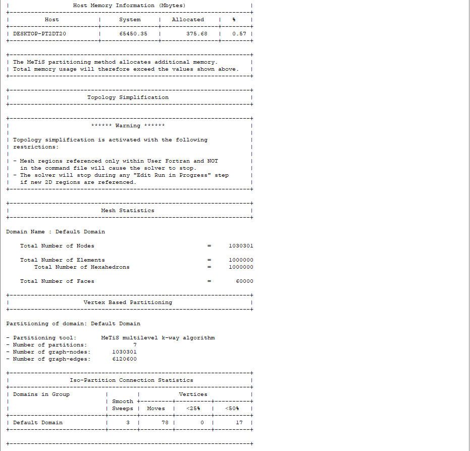

SubscriberWhen the initialization (preparing run step) is going both my CPU and RAM are being utilized by the solver.mpi under the workbench; however, when that process finishes it never initializes the solver.mpis to actually solve the model as it would normally (seen on other computers)nDecember 2, 2020 at 4:39 pmDrAmine

Yes can work but you are at the limit. Can you perhaps try launching in batch on the machine? Is the definition file on that machine and the working directories is local? Can you try starting with large problems definition turned on? Please paste some more context of the outfile.nDecember 2, 2020 at 9:19 pmhilooi
SubscriberI will add more screenshots when I get home, but in the meantime what do you mean by launching in batch? Also I do have large problems definition turned on, however I'm not sure whether the definition file is on the machine or whether the working directories is local; can you elaborate on how I can find that information?nDecember 3, 2020 at 4:03 amDecember 3, 2020 at 9:11 amDrAmine
Ansys EmployeeYou are running using the Workbench (as far as I can identify) is this correct? nDebugging this kind of problems requires time and luck (especially as we from Ansys do not ask for files). Can you try using another number of CPU's, another partitioner ( I do not thinkg the issue is related to this), another Parallel method, disabling FireWalls and Defenders and AntiVirus.nDecember 3, 2020 at 1:12 pmhilooi
SubscriberHi by another number of CPU's do you mean a new CPU? I have tried both IBM and Intel partitioners, they have a similar issue. by parallel method do you refer to running parallels with multiple PCs, as I probably do not have access to that. I can try disabling firewalls, defenders and antiviruses; but I tried that before and it had no success. Is there anything else anyone here can think of or anyway to get more help on this? Thank you.nDecember 3, 2020 at 1:30 pmDrAmine

SubscriberA little bit of an update, I tried downloading ANSYS 2020R2 student version and running it, the same problem is occurring. Furthermore, when I try to initialize fluent on either serial or parallel it does not work either (on the ANSYS 19.2 version i had and the ANSYS 2020R2 version). It is almost certainly my computer, any idea of what could be causing this would be amazing; whether it be MOBO issue or any other hardware, driver or anything else. Thank you.nDecember 4, 2020 at 10:39 amRob
Forum ModeratorFluent loads, but then fails to initialise? Any errors or does it hang? Check the disc space for the temp folders, too. nDecember 5, 2020 at 6:30 amDecember 7, 2020 at 9:04 amDrAmine
