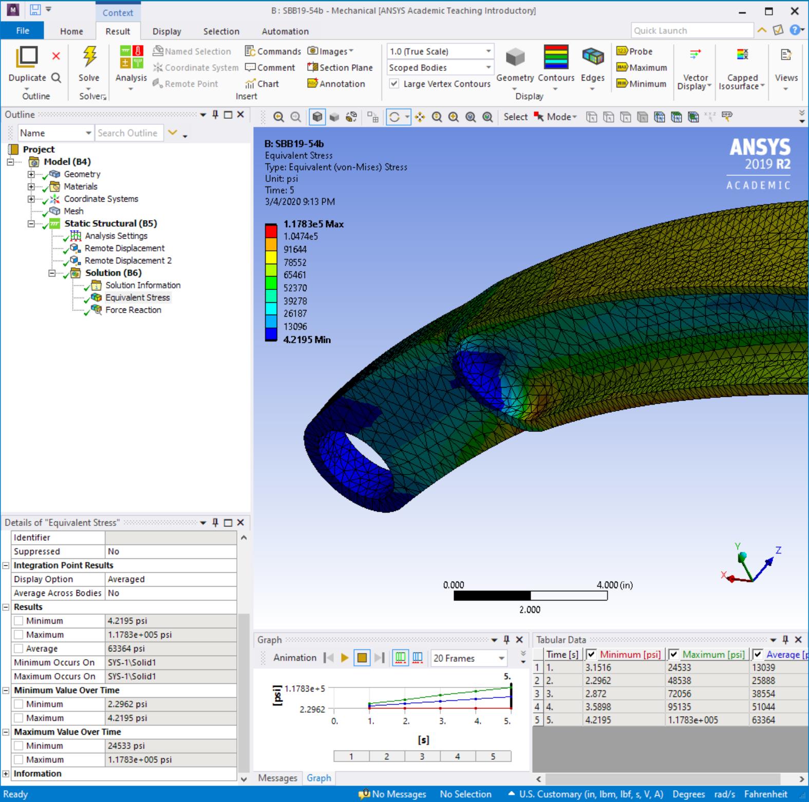

  • rejedejorejedejo Posts: 2Member
    edited March 2020
    There are issues with way the problem size is calculated. I was able to solve a problem with 80,236 nodes and 43,103 elements.
    Now I'm getting this error:
    "Your product license has numerical problem size limits, you have exceeded these problem size limits and the solver cannot proceed."
    with a similar problem that has 11,187 nodes and 5,340 elements
    This is a totally new instance of Ansys WB, subtly different geometry, and the only system in this *.wbpj file.
    These two cases demonstrate there are issues with the node/element count.

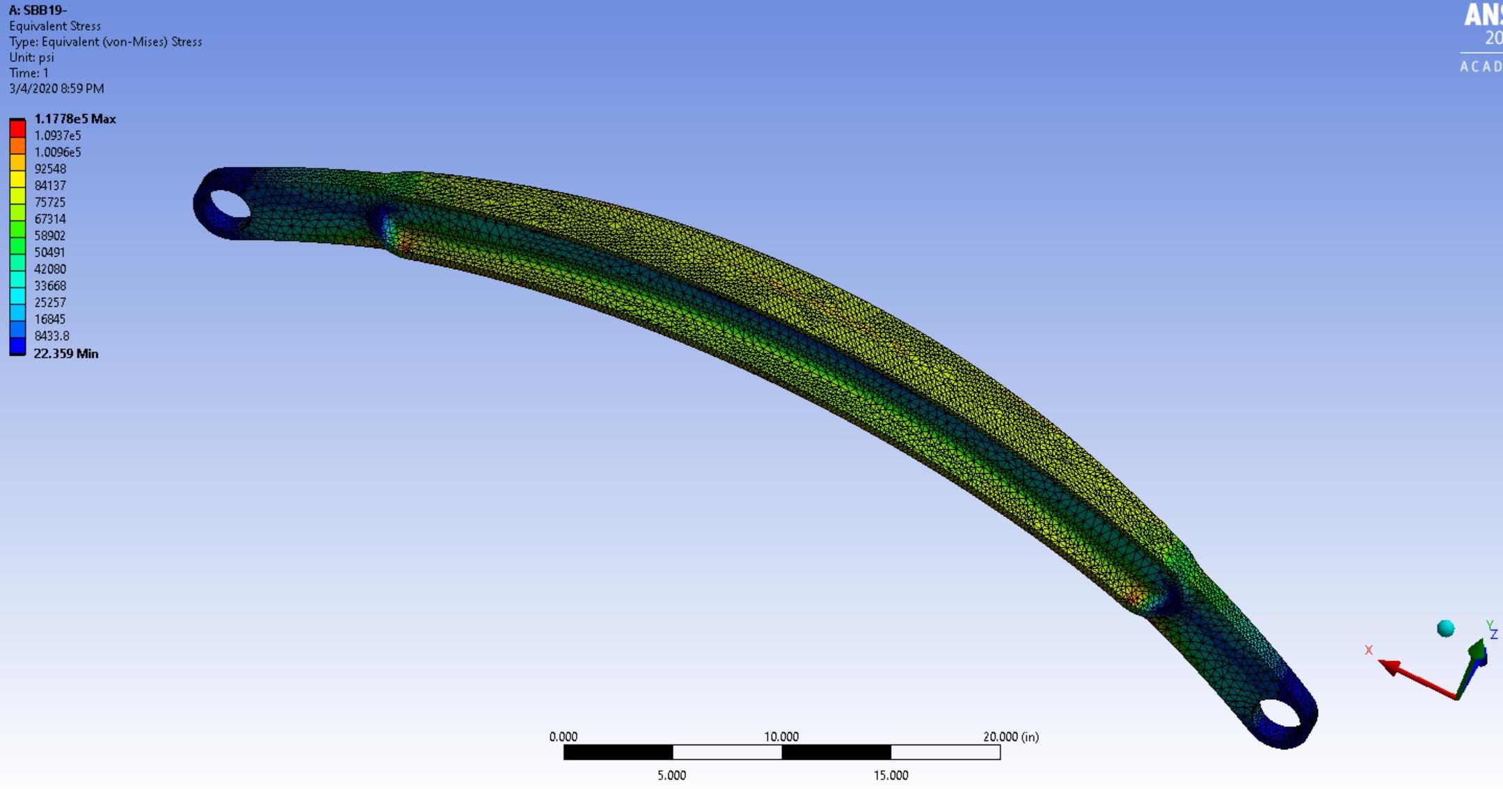

    edited March 2020
    showing another couple images demonstrating clearly the overnodes
  • peteroznewmanpeteroznewman Posts: 11,981Member
    edited March 2020
    I assume you don't care if the solver runs when there are more nodes or elements than the limit.
    I assume you do care when the solver doesn't run when there are fewer nodes or elements than the limit.
    I have found that by inserting a Mesh Numbering item into the outline, you can force the mesh that generated an error be be renumbered and allow a mesh with a count below the limit to run.
